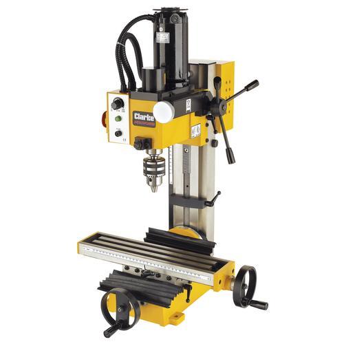

Just got hold of one of these.....see pic
Sold by Machine Mart
Brand Clarke CMD300 3-axis mill
Was originally looking for a decent TIG welder and walked out the shop with the mill and a few other goodies. Smuggled the pallet (they delivered a pallet!! with all the tools I had acquired to the back door) into the shed and ripped open the box.
Nice machine but has taken a few evenings to get it set correctly (lapping the ways, jib screw adjustment and general shipping grime cleaning).
I am going to cnc the mill and will then be able to make some much needed parts for the GT.

Hi Doc,
Any issue give me a shout. I have a Clarke X1 clone I CNC'd last year, and a bigger RF25 (round column) clone for heavy stuff. Thinking of porting the CNC stuff onto the bigger machine if I'm honest. The X1 has worked well for me though, if a little hands on. Great for small stuff and alloys, slow going in steel! I used one of the cheap Chinese stepper kits, though was very glad I went up a size on the motors very extra speed and torque. Have a £20 PC in the garage running Linux to run it.
