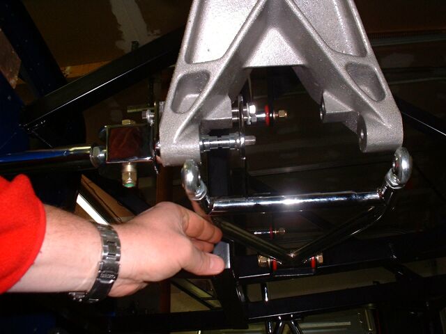

I ran into an alignment problem trying to match up the lower arm to the upright...it was off by 25 mm (that's an inch to you backwards SAE types ). Turns out I had two sets of lower drag links, and one of them was 25 mm shorter than the other, so I swapped them out and all was well. A nice touch that Bob Lawrence did here was to powder coat the uprights clear. This way they'll be easier to keep clean.
File Type: jpg 24247-misalignment - wrong length lower drag link.jpg (51.5 KB, 976 views)
