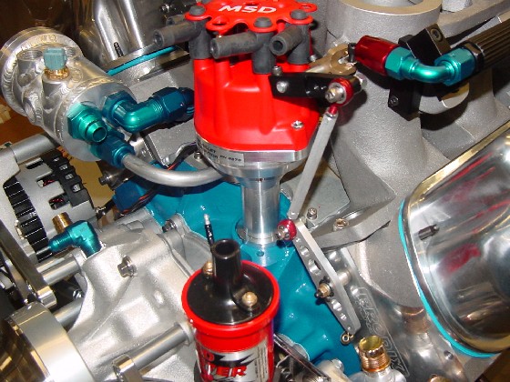

Thermostat housing.
We called this Frankenstein's (?sp) Baby. It was pretty ugly when he was done welding, and before it was polished up. It started life as a piece of tubing.
The two of the three blue lines are returning water from the front corners of the intake manifold. The lower line is returning water from the two in the back to avoid steam pockets as discussed by Blackjack in "HEY, ROB LOGAN ---".
