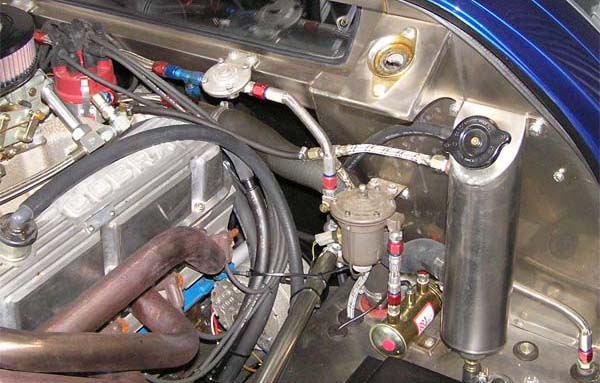

T Hughs, My CAV was altered to let the air bleed off the top of the intake and " T " into the top of the filler tank. The filler tank was also raised up about 3" to 4" to allow the air to move above the block. This made filling the cooling system much faster and solved the problem of getting the air out of the system. The bolt just to the right and down from the top of the filling tank is the old position of the tank when it came from CAV. I have had no heating problems even when the temperature got up to 98 degrees. Hope this helps. Joe [img]/ubbthreads/images/graemlins/smile.gif[/img] [img]/ubbthreads/images/graemlins/smile.gif[/img] [img]/ubbthreads/images/graemlins/smile.gif[/img]
