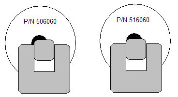

I had heard rumors that Jesel had once sold their Sportsman Series shaft mount rockers, part number KSS 506060 to go on AFR heads and then switched to part number KSS 516060. I recently bought an unused set of rockers advertised as KSS 516060; however, when it arrived, I noticed that the side of the Jesel box said KSS 506060. When I contacted the sellar he was very apologetic and immediately offered me a refund. He had purchased the rockers for his AFR heads and then decided to scale back and race in the pure street class. When he advertised the rockers, rather than going to his shop to get the part numbers, he just looked it up on Jesel's website and put the current number in his ad not knowing there had been a change to the number in the interim.
Now, when I mounted the open 1/2 of the rocker system set on one of my heads, I immediately noticed that the intake rockers were slightly off line towards the front of the engine. I moved them within the tiny bit of play in the system, but never could get everything to line up to my satisfaction. So, I emailed Jesel. The tech guy there said that, "We were selling P/N KSS-506060 for AFR heads , but that is before we got a head and realized it took a slightly different set up." When I asked him if any effort had been made to correct the issue for those who had already purchased ill fitting rocker systems, "I do not believe there was Lynn" was his response. The only thing he said in terms of getting properly fitting rockers was, "KSS-516060 is $695 if you have to purchase it through us."

I mocked up a head tonight with the rockers. I was mainly looking at how the intake roller lined up with the valve tip. It is much better than the KSS 5060606 rockers, but, amazingly it isn't as balls on centered as I thought it would be or as the exhaust valve is. I don't think there is going to be any issue with running them, I just thought they would line up better. It could be the way the valve springs are set too. The stock AFR spring set up is actually pretty crappy and, as I have mentioned else where, the valve springs have way to much freedom of motion. So, things might line up better when I get the good springs, locators, proper retainers, etc on them. I really hope I don't have to reface the angle cuts on the valves and then reseat them. That would be an expense I hadn't counted on.

Well the Pro Magnum rockers are installed and the tips still won't center, except it's only on some of the valves. AFR says to put some ARP studs in it, this helps because their longer but the stud holes are still a little off on some of the valves. This confirms what the machinest says that ARP uses some economy hardware. The ARP studs definitely improve the centering buts it's still not exact.
I guess I didn't know what to expect with mass produced A.M. heads. The tips are also off center in the front to rear direction also. Measuring the distance between studs shows a .025" max difference. A straightedge from front to back shows a .015" difference. The threaded stud holes are inserted with heli-coils which I've never really liked, and think this may be contributing to innacuracy.
