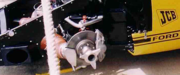

Ian Anderson
Pictures of originals from Le Mans lClassic last year - I cannot find any detail on the rears - but will keep looking
