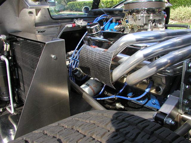

Here are a couple of things I've tried that seem to work. I put an BSR heat shield between the headers and the Air Conditioning condenser coils. It's greatly reduced the radiant heat. Boeing makes the shield and they use it for spacecraft. The other is a more presentable aero type inner filler cap option from Newton in England. It's from a motorcycle gas tank. Please share if you have a solution for the good of the order.
