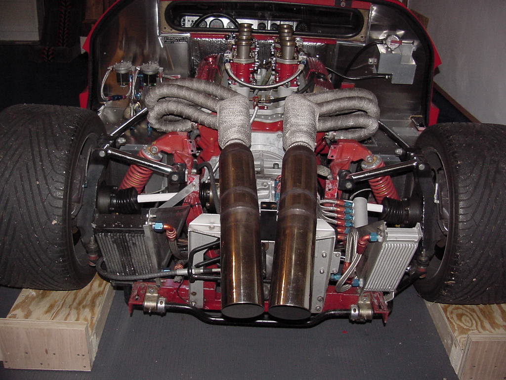

Tim, here is a shot from the back and from about the centerline of the wheel. Remember that I moved my engine foward and lowered it to get these axle angles. Front to back the axles are almost on the hub centerline. Top to bottom the transaxle output hub centerline is about 1.25" higher than the wheel hub centerline.
