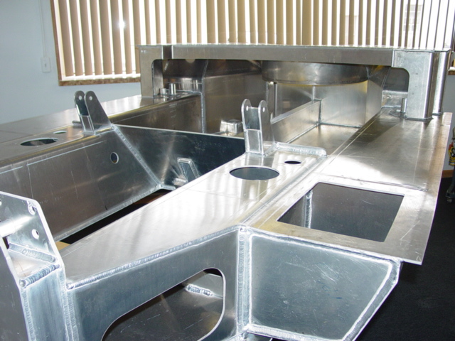

That is a pretty impressive figure you got there on a not completely fitted chassis. I would think a stiffness factor of twice the vehicle weight would be a good number, and it seems you have probably tripled yours already. Not knowing what your target for finished weight is I am assuming less than 3000 lbs.. I am curious though, if you can get the stiffness up to lets say 10,000 ft. lbs./ deg. are you going to lighten the chassis even more? Just a thought.
Take care
Phil
Phil,
the jump to 10,00ft.lbs/deg is a lot more difficult than achieving the first 8300ft.lbs...the add ons will only add 500 or so to the figure...not that my final anaysis should be belittled by this ..quite the contrary.
I am very pleased with our design and very confident in its abilities.
I appreciate the feedback but I will not be reducing the mass of the chassis as I want to maintain as much integrity as possible.
This is America after all..land of the free and home of the Attorney.
The finished weight of a GT40 with a SBF and a Porsche transaxle is under 2200lbs..this is not a luxury build with AC etc etc etc...
The original Chapparal 2E chassis had a torsional ridgidity of 3200lbs and the Lola 3b of around 5200lbs so with the modern replica market being at the cutting edge of consumer demand I feel that I should stick to my mantra of design and leave well alone...
The RCR70 chassis pictured....

Gary,
there are close off panels that are not shown...there needs to be access to be able connect fuel filler hoses etc etc etc. but good a point.
No problem Fran and I do not want to come off as picky, but if possible I might suggest the structural walls be on the inside and full welded and the access panels be from the side or wheel well. Just a thought.
Fran
I didn't want to come across as being critical, just had that thought. I thought that your finished vehicle would be a bit heavier. I TOTALLY agree with your comment about the car being race oriented. I have seen too many replicas loaded with gadgetry and unnecessary options, and being a purist myself I enjoy the original look and feel. I can do without leather seats, leather covered dash etc., and I realize to each his own but The GT40 is what it is. By the way, nice welds. I assume you are using a watercooled torch, and probably spent hours in impossible positions getting the quality you wanted there. I have to say you have a pretty steady hand. Looks great!
Phil
Phil...
not at all...I was just trying to be informative to others and appreciate the input...
I would love to take the credit for the welding (I did the first ones)but I now have two great welders working for me...Bob and Justine...yes a young lady....we have a rotating jig with a huge heatsink plate to reduce metal distorsion and that makes life much more pleasant for them....weighs a bloody ton though... /ubbthreads/images/graemlins/grin.gif

Fran,
Nice to see those rounded corners on the suspension arm clearance openings as opposed to stress raiser sharp corners in earlier pics. Was going to say something but was biting my tounge.

no sweat..that was an early development chassis ...never released in that form.....you should know me better than that.... /ubbthreads/images/graemlins/grin.gif...but thanks for keeping the faith
