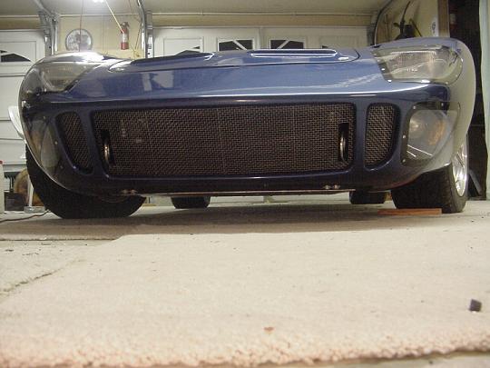

I made up stainless panels for all of the holes on my car (radiator, brake vents, induction holes, side scoops, rear clip), and never noticed any change at all in running temps. My panels are all glued directly to the glass, using split 1/4" vacuum hose as gaskets.
