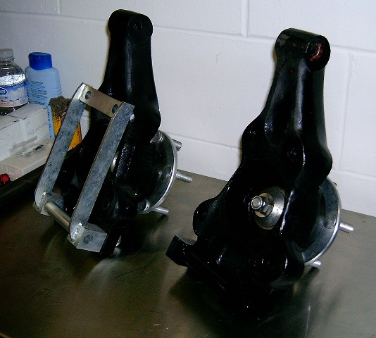

The brace on the rear hub was required to reduce loads caused by placing shims under the rear most retaing bolt of the mounting bar for the lower control arm. Now that arm is solidly bolted flat to the hub and you can kiss the brace goodbye.
