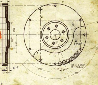

If it's for the G50/Porsche clutch and it's a windsor motor with a 28oz or a 50oz counterweight .
At the very least it needs to be match balanced with the original flywheel that came with the motor--would recommend a full rotational assy. balance incl.clutch.
Flywheel should look something like this to start with [img]/ubbthreads/images/graemlins/twocents.gif[/img]
