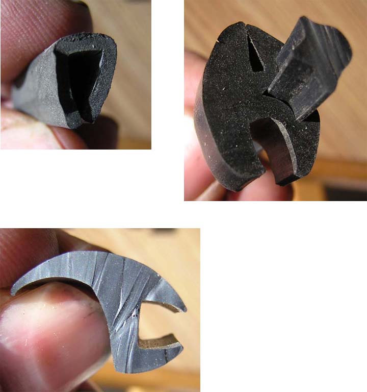

Simon,
The upper left photos is the trim piece that goes over the fiberglass edge of the windshield opening. It's a staple shaped profile. It does not go all the way around the winshield. It starts at the lower A-pillar then goes up and over the top then terminates at the other A-pillar. You do not need this on the lower adge as the dash covers this area.
The upper left photo is the rear bulkhead glass seal with the locking strip placed in it's grove on the seal. This locking strip is what I think you have in you in your photo.
The lower photo is the windshield and the rear glass seal.
