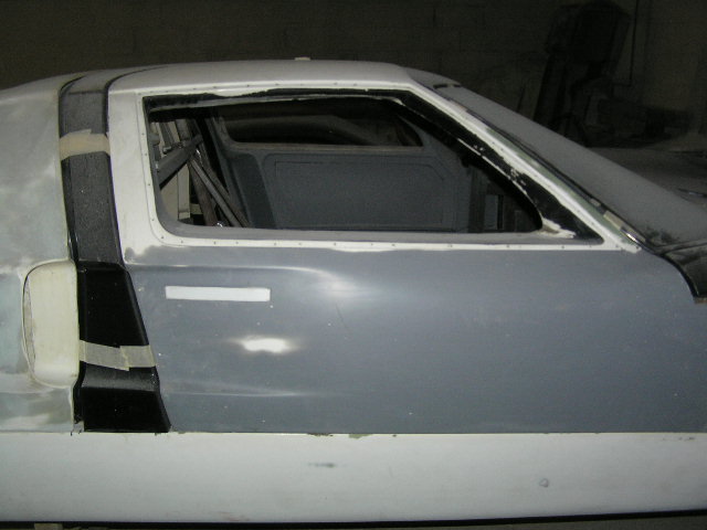

Not being the photo bug, I had a ton of shots of chassis and body in HI-Res, (860 kb) and could not post. I recently took some photos of the body....sorry about the dust! and thought I would start posting my project. I will try to re-size the chassis photos as the body is currently on the chassis for fitting, and I would like to continue with that right now. As you all can see some of the panels are older, these were tuned-up for the molds which are now done, but I am using the older panels as I fit and look for possible changes in order not to damage the new stuff. The spyder and nose are new, and that rear decklid is an original spare piece with original magnesium hinge plates on it...A lucky find, and I am currently working on that mold. The rockers need to be matched and those and the rear deck are the last two pieces to be done. I am hoping to get those chassis photos re sized soon and post them ASAP. Merry Christmas to all.
