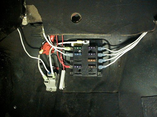

These cars came with no fuses [img]/ubbthreads/images/graemlins/flamed.gif[/img] I added a fuse block for safety & a relay so that the only current that passes through the ignition switch in the ON position is the power to the relay. Headlights and starter solenoid remain unfused [img]/ubbthreads/images/graemlins/shocked.gif[/img]
This is mounted on the firewall in the passenger footwell. I need to make a cover for it so it doesn't get kicked.
