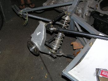

Some additional photos of the bodywork and rear suspension. We had a problem with the spyder fitting, and the solution was to trash the first piece, and fit a new one installing the inner panel first, then bonding the outer to it...seems to fit much better. Concentrating now on fitting the doors and spyder together. Also I am working on a new upright assembly to replace the ones you see here. Will post more as I progress.
Phil
