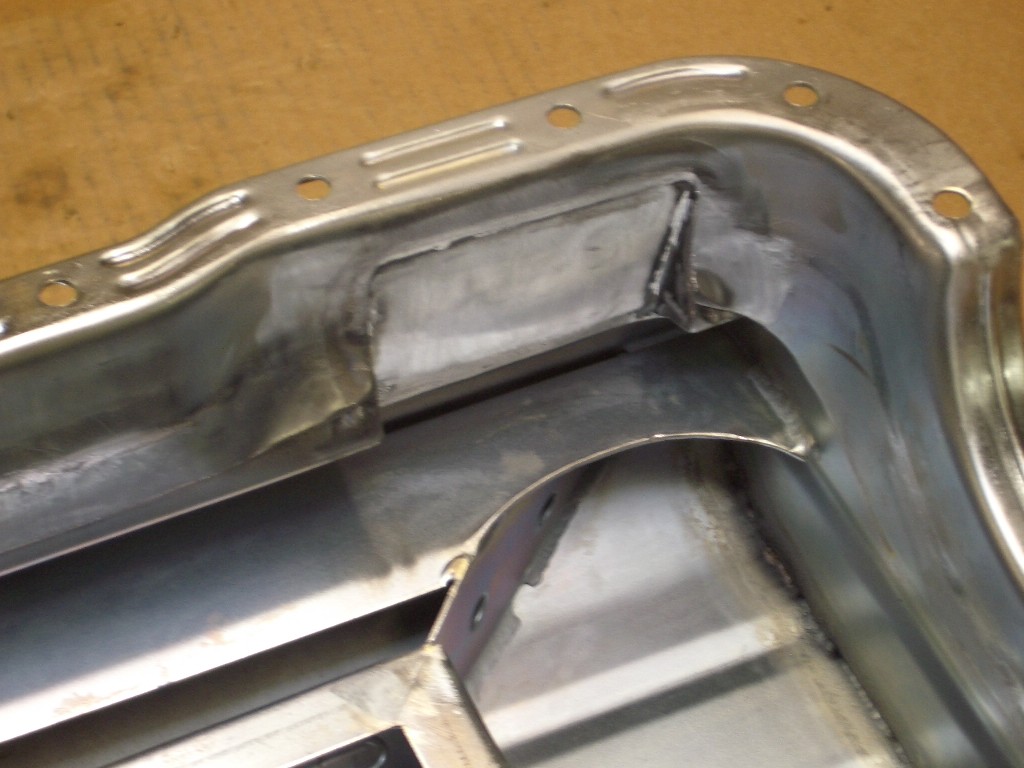

After the outside cap was welded in place, the inside interference area was cut away and the edges were smoothed. There is still plenty of clearance around the starter motor and I have the added strength of a girdle on the main bearing caps. If you want an Armando pan done this way, I am sure he would be happy to accommodate.
