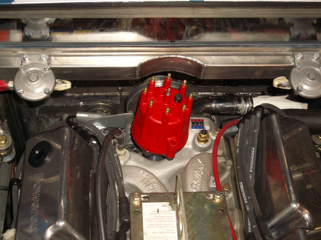

The distributor on a small block Ford exits the block at an angle, so to make the distributor end up looking centered in the new indent, I biased the cut out slightly to the left of chassis center. To make the indent, I used an extra thick (3/16 inch) piece of stainless steel. It was curved, recessed inside the channel of the chassis, and then seam welded.
AFTER this picture was made, the engine and transmission were moved to a final position for a total overall forward relocation of about 1 1/4 inches. Then, with the added height of the spark plug wires, the top of the distributor appears centered in the cut-out.
Ian Clark
Nice piece of work Bob! The recess looks great. It's also worth mentioning here the material thickness on the CAV crossbar is .125 almost three times the original...
