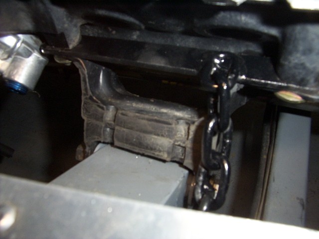

I've welded a chain in as the pic shows, to the steel strap under block mounting and the other end to a piece of 3mm bar under the bolt head. This bolt is a 1/2" not 7/16" and is high tensile. That will do for now but I would like to hear of other methods you've alluded to.I have to carry on and get the rest together now it's Phillip Island next weekend and I would like to go to friday practice too, if I can make it.Should be ok.
Ross
