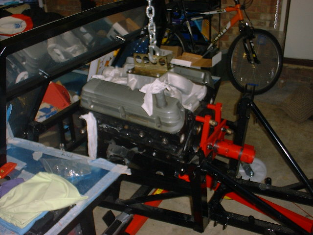

With the right Engine mounts, the motor fits!!!!!!!
Early Mustang mounts come in 2 sizes Tall and short. I needed the short. Picture quality iffy, it was taken in made rush with a phone before something went wrong. this moment rekindled the build for me, panelling was getting a little boring.......but the late purchase of a air powered/hydraulic rivet gun made it a lot more fun, anybody out there about to start panelling, get one now!!!!! i used a lazy tong before and that was getting hard work and the plier type hurts. the new one not only makes a cool sound but can also reach the parts that the others couldn't reach
