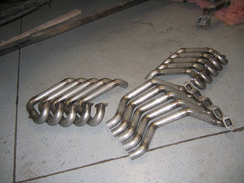

All segments are slip fit and welded as original. Cylinders 4 and 8 are two piece to ease assembly (read make it possible to assemble). The transition from round to rectangular is reinforced with an additional layer welded to the flange and pipe. That transition is 50% of the work for each pipe. Believe me, MKI pipes are childs play compared to these suckers.
