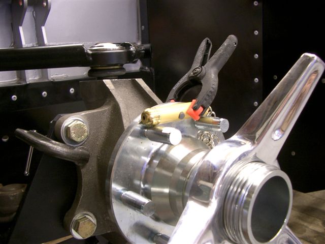

Maybe this will help, it's one of the best & most simple ideas I've seen for checking bump-steer.
You can see in the photo I clipped a laser pointer to the hub. you can pick up these in the uk for 3-4 pounds.
All you do is pin a sheet of graph paper to your garage wall where the pointer strikes (the further away, the more accurately you can measure) & you can plot the amount of 'steer' as you raise the suspension on, say,wooden blocks, 1 inch at a time.
you can easily clip the pointer on different parts of the suspension & track & mark the different radii of the various suspension components (as pointed out by Phil).
