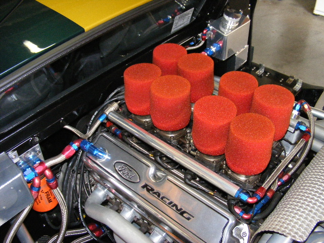

Re: Rf80 Reborn!!!!
I sourced my intake through Wayne at Cool Parts so it did not have any RF mods done to it.

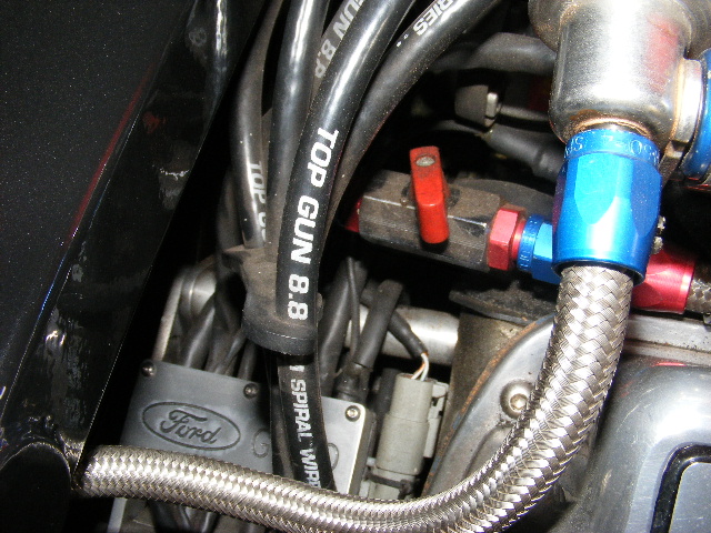

I did install the RF style bleed lines to the back of the intake as shown in the picture. I have heard no negative comments about this mod, only that it helps improve engine cooling and here in Florida anything that helps that area is good.
One area that was a slight problem is that DC&O and RF positions the TPS sensor at opposite ends of the intake, RF at the front DC&O at the back both on the same side. I have had to make an extension that allows the RF harness to reach the DC&O sensor location.
Other than those things I noticed no other differances between that unit supplied by RF and the DC&O.

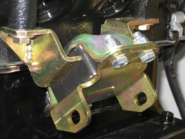

Did you do the complete mod on the tranny mount? If so what rubber mounts did you put between the frame and the transmission mounts, and were did you get the?
Peter, I ordered a piece of 1-inch thick by 2-inch wide Delrin from McMaster Carr #8662K63), and cut it into two 2" squares, and drilled a hole through each to accomodate the trans mount bolts. These pieces are sandwiched between the chassis rail and the bottom of the trans mounts. You can see them in this pic (I've since had the trans mounts plated):
