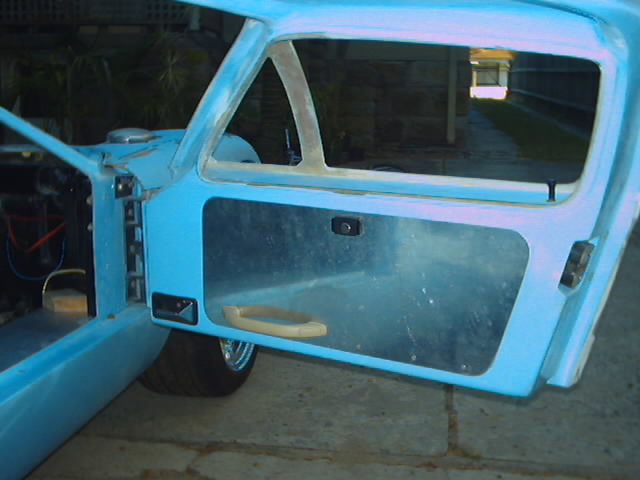

The doors have the Mk3 opening windows fitted.

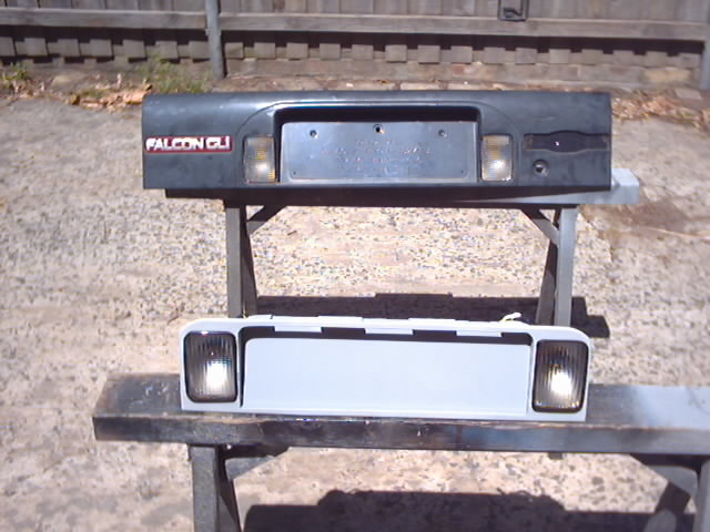

One thing I wanted to have that would look finished and professional was the treatment of the number plate,and associated required lighting.
I saw this ford trim and as it was too big to cut down or fit I made this one up from 3mm ally plate which will house the number plate,reversing lights,and plate lights,and make the rear of the car look like a factory supplied fitting rather than a collection of aftermarket bits.
All lights,indicators,tail lights have been fitted most of the body work has been finished and is now undercoated and will be getting its paintwork shortly.

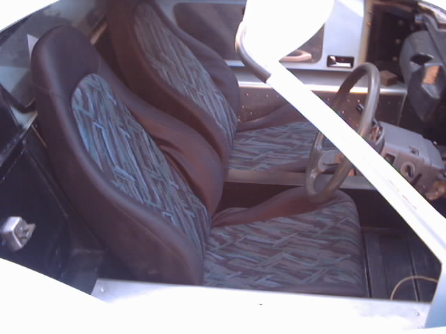

The dash has been covered in the same coloured material as the upholstery and the gauges will be fitted this weekend(all VDO instruments)
