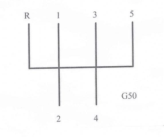

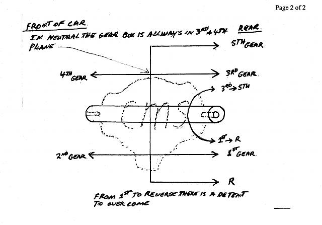

The attached drawings detail the shift pattern and the way the side shifter interprets gear changes.
