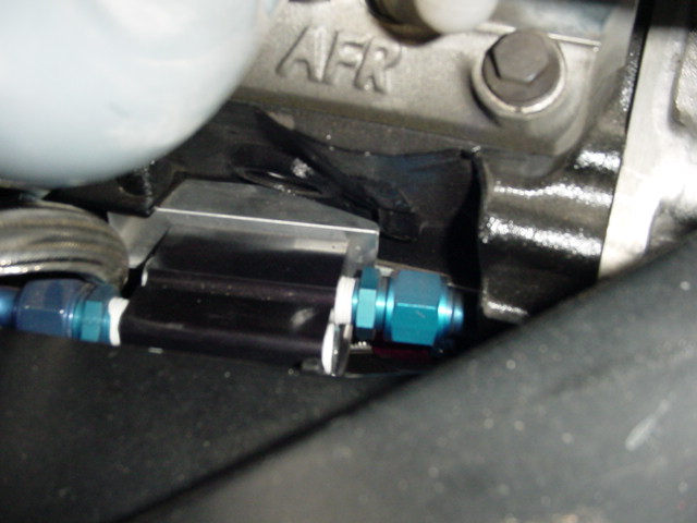

This is the remote engine oil filter mount on one of Olthoff’s installs. It is bolted to a bracket that is bolted to the engine block by the rear engine mount bolt. The oil flows from engine to filter………..cooler………..back to engine, Canton makes a quality billet mount that fits well in this area and takes the FL-1A.
