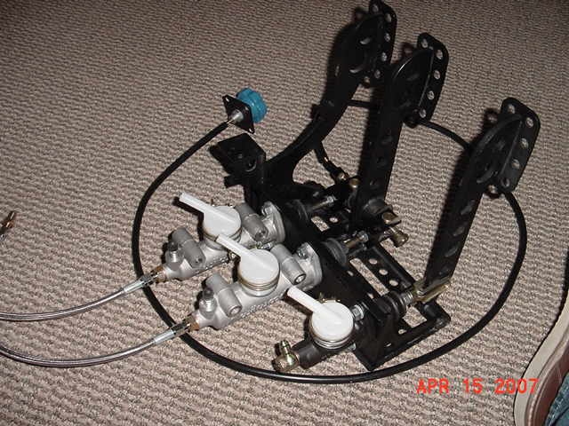

I completed the pedal assembly assembly this morning and it looks pretty good. I used the 3/4 Tilton 75 series for my clutch, 1in Wilwood for the rears and 7/8 Wilwood for the front. I was not sure about the front and rear master sizes so I called Al Nichols at Wilwood who works with Fran and he suggested this set up. We will see how it works. I added the balance bar adjustment to tha pedals too.
