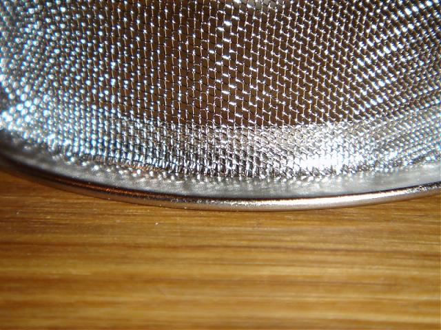

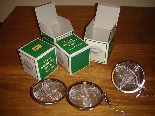

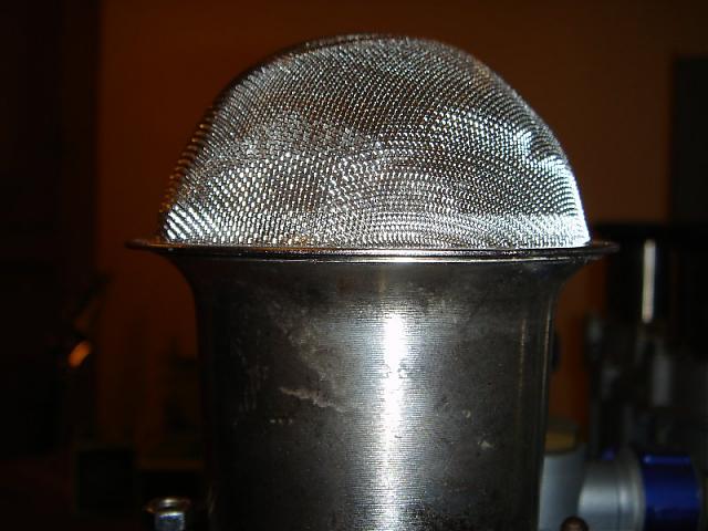

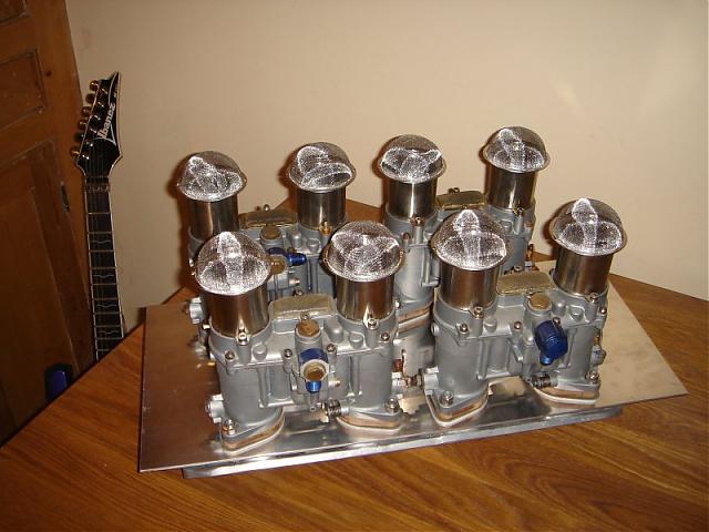

Ok second batch of screen filters..... just for you UK guys...
Much better than the first set...
Supplier....

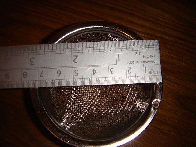

Cookshop UK - Headcook and Bottlewasher Kaiser Patisserie Range Tea ball infuser strainer 7.5cm
Total of £10.75 (that includes postage!) for 4x75mm infusers, note the 75mm is the outside rim on this one, the inner diameter is 65mm. Difficult to estimate the open area but the end of a g string goes through it ( 14 thou diameter steel wire) and a d string dosent (22 thou). See that Ibanez aint just for show!!! lol
Carefully prised off the hinge piece and then used pliers to twist the pin under the latch until it twisted off. The latch and remaining part of the swaged pin lifted off, 3 minutes all done.
Just not sure I want to glue them on though....
Andy
