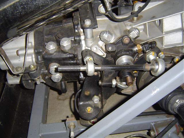

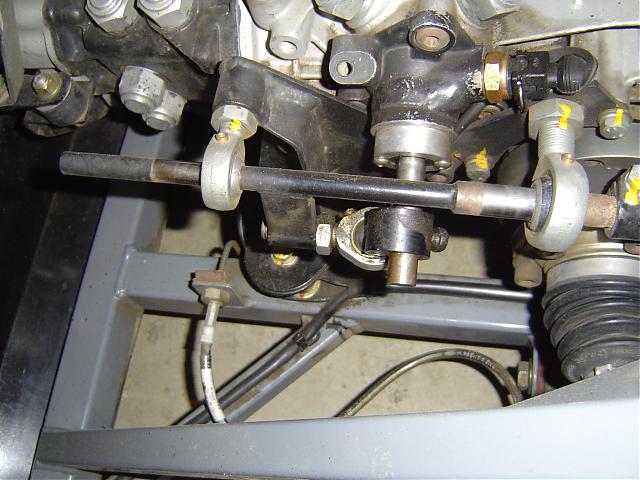

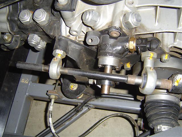

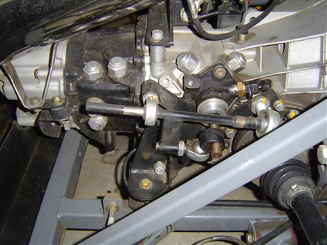

Hi Huw,
Attached photos, first overhead in neutral, second photo side view in neutral, third photo overhead in reverse, forth photo side view in reverse, hope these assist. As Bobski has mentioned they can be difficult to select gears without the engine running mainly due to the gearbox being dry and oil not being splashed over the syncros. Mine was like that until I had run the car.
The positioning of the lever off the selector shaft is critical to successfully get all gears and reverse, the locking nut needs to be done tight and loctited to prevent slippage on the selector shaft.
Andrew
