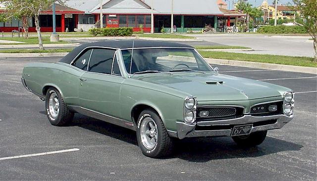

Oddly enough, it appears that PPG does not list paint codes unless one is subscribed to the PPG website. All of my older links do not bring up the pages anymore.
Correct me if I'm wrong but I can only find Linden Green as a 1967 Pontiac GTO paint code - H Code to be exact. There may be a Euro paint equivalent.
See pic.

As for whether the Ford version of Linden Green matches its namesake from GM, I don't think I'd bet too much on that... :)

I know the GM color will not be. No way Jose! But curious about how close could it be the actual color, with the same name, in both sides of the Atlantic.
