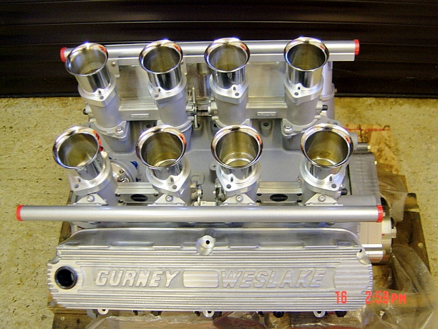

How's about this manifold I put together a while ago ? The pots are 48mm straight bores to the butterflies with no venturis. Lucas style injectors.
I never tried it but wondered how much power it would give.

Hi James -
Nice looking setup - Jenvey Dynamics?... I was up there earlier this week as I'm putting a set of 48s on a 347 at the moment. I'll post pics once I have it together.

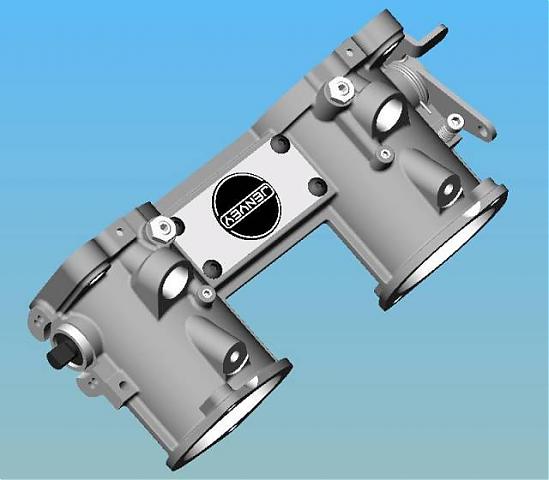

Check out Jenvey IDA style throttle bodies on Jenvey performance induction systems
They do 48mm and 50mm size. Pic attached. They are about £300 each. Air horns about £20 - £40 each. They don't yet do a SBF manifold but John Wisher does them at about £800 each in original FAV style (v. nice).

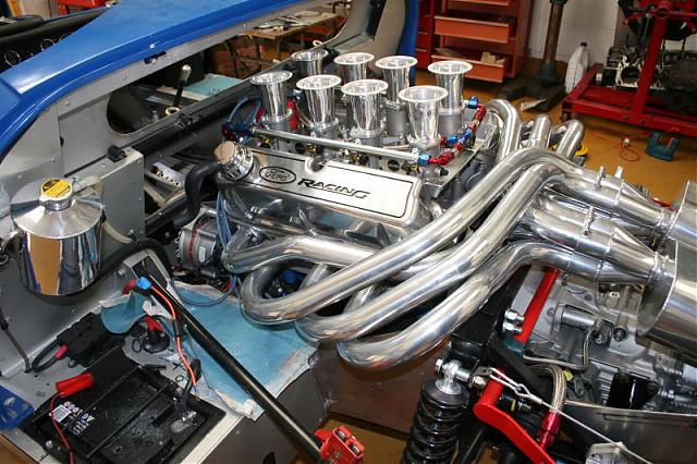

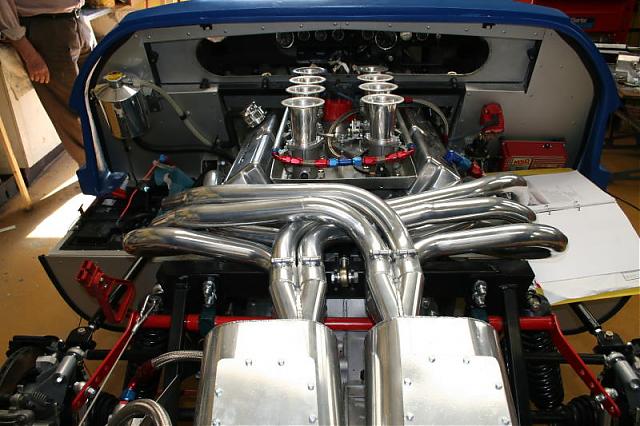

I now have the Jenvey setup, awaiting to be fitted to 347 on an RF.
All looks very nice, centre pull (to rear) mechanism looks good and tbs look easily adjustable for air bypass. The injectors, sized for 450-530 BHP are nice too, 'Pico' items that are really quite small. If id realised just how small they were I might have had a look at the 'hidden injection' concept some time back as I'm sure they fit beneath a turkey pan relatively easily.
This is going to look good though (IMHO) and I look forward to the day she fires up for the 1st time.:) Throttle dia is 48mm and the trumpets are 40mm as specified, but I have option to swap for 60/90 or 120 should space permit.
A few pics.

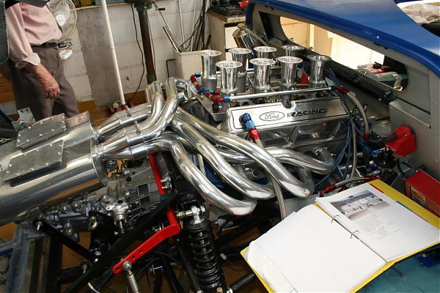

The picture used by Jenvey in their advertising is the first IDA set up Richard made and was for my car. They are of 50mm bore and I have found them to be faultless in operation on my 7.0ltr motor. Thoroughly recommended !!

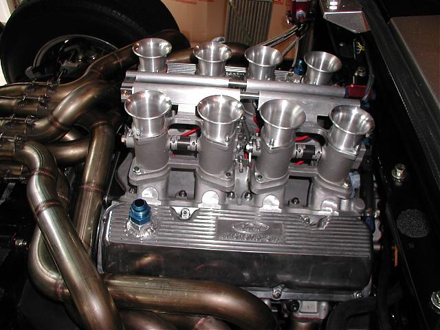

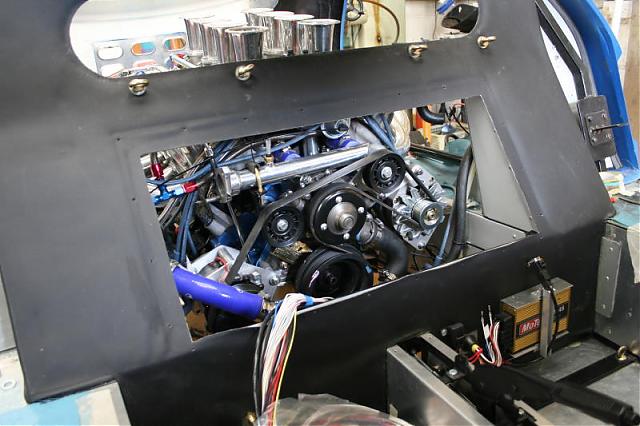

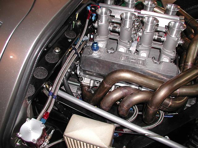

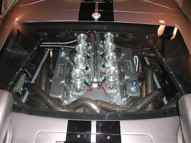

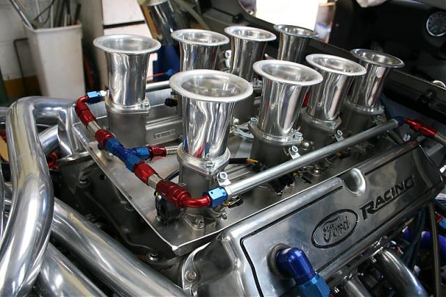

Was working over Roy's today, and remembered the camera for a change, so here are a few pics of the Jenvey install. Obviously its not finished yet..:D

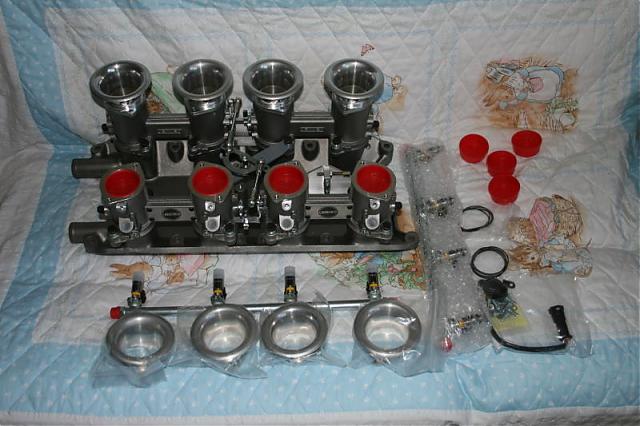

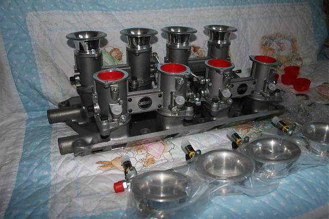

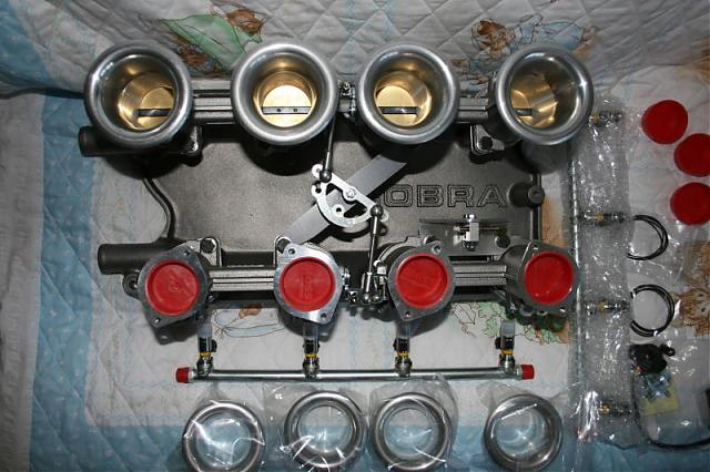

With the help of Mike Trusty, I've got a system based on TWM throttle bodies and an Electromotive TEC3r ECU and am in the process of installing it now.
I've got most of the basic installation done. Pending is the trigger wheel, final wiring hookup and tuning.
FWIW,
Kirby
