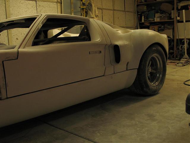

Sill extensions mounted. I hit it with a little white primer to get the feel of what it'll look like. Then I started sanding and then with the bondo. That's going to be some labor intensive stuff.
Martin - These are the 2"/side flares from Fran and not Gulf sized. I think they look great and still allow me to use a 15" wheel under a flared rear clip without going to race rubber. Thanks for the encouragement (yours are looking great too BTW), but I have a feeling I've only just begun.

Chris,
I should have read Frans post stating they are not Gulf flares. I see now they are not, but i still like them a lot.The profile looks really nice from sill to arch, you've done a good job there. Going with the large spot lamps also. I'm looking forward to seeing more progress. I found the bodywork painful, but ultimately rewarding. I can see the light at the end of the tunnel now and you are not far behind me on that score. Keep grafting. ...:D

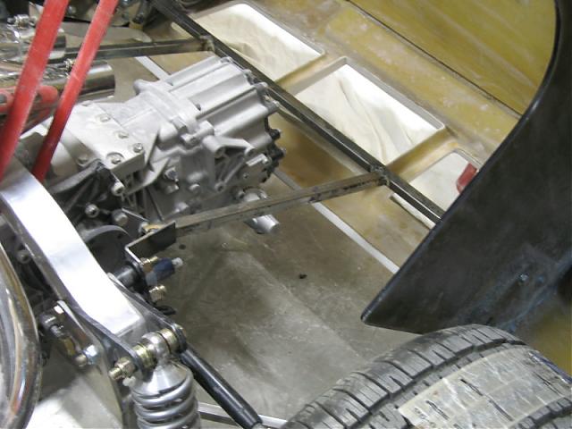

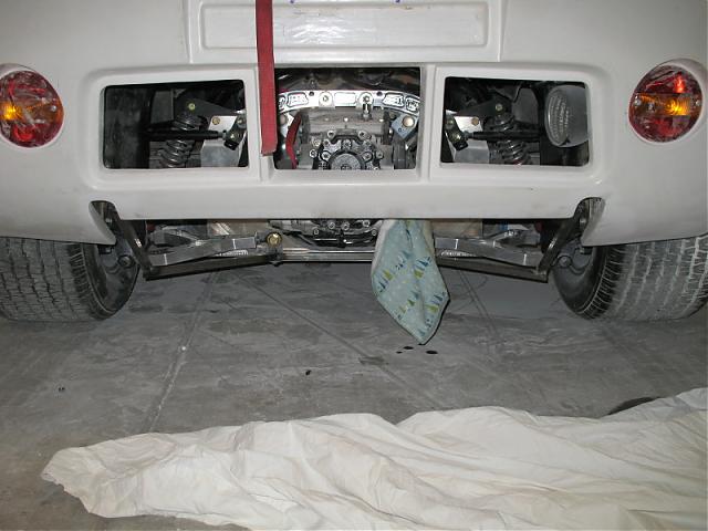

On the rollouts for the pictures, I noticed the rear clip wasn't level to the ground. I figured it was an illusion, but after looking again, I got out the tape measure and started investigating. Sure enough, the left side was about an inch lower than the right.
After my 4 months away, looks like things settled. Before committing the flares, I set the ride height and made sure the gaps were what I wanted but I didn't check the basic squareness of the clip to the ground. Ugh! Once corrected, the flare was an inch higher and I don't want the uneveness.

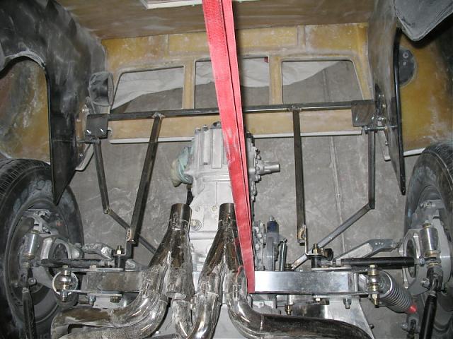

So what to do? I always wanted to do something like the MKII rear support and create some luggage space (much like Dave's RCR MKII just posted this morning- looks fantastic, BTW!). I took this as the opportunity to do so. I picked up some square tube, got out the welder and chop saw and went at it.
The pics follow, the first one showing the twist (take a look at the ovals on the top vent panel, comparing right to left) and then a few of my new subframe. I still have a little reinforcement to do, but it's already sufficiently rigid to get the job done. It's pretty cool what a protractor, a tape measure and some common sense will get you.
Once the clip has settled on its new digs for a little while, I will figure out what to do about the flares. If anyone has suggestions, fire away. I'm all ears.

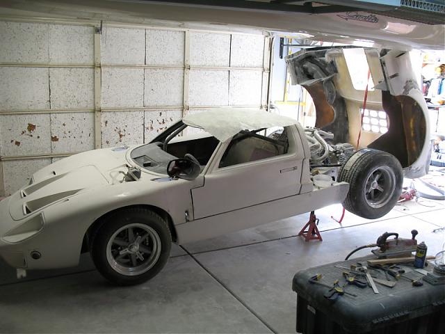

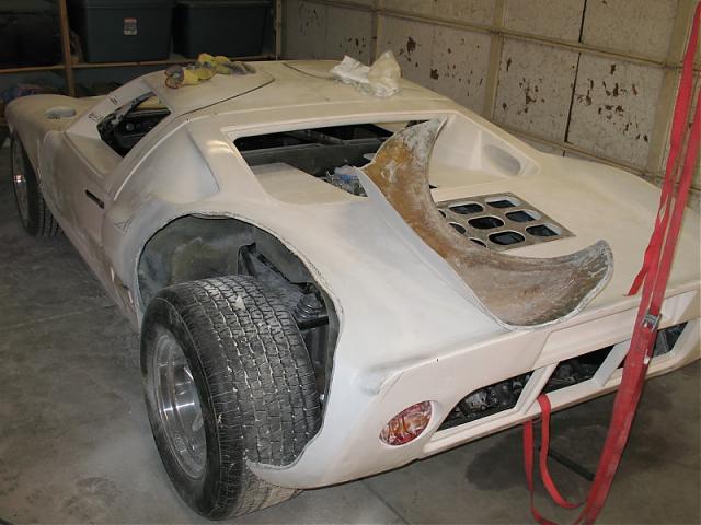

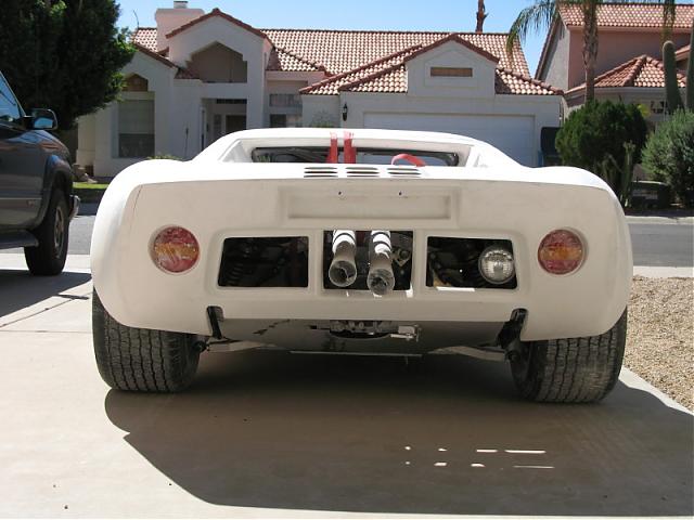

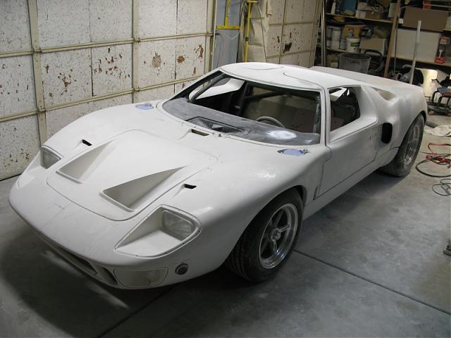

More steps forward! The driver's flare didn't settle after I had reset the clip with the rear panel square(-ish) to the ground so I decided it needed to be moved. Nobody seemed to have any suggestions here either.
The car when I woke up this morning:
By 10am the clip was cut out. This took a little courage.
Before 1130 it was screwed in place.
Spent the rest of the afternoon generating pink snow and fiberglass dust.
Getting closer:
And the final product for the day:
The funny thing is how quickly this one went- from pulling it off the car to resetting it and filling. I was clean and having dinner with Bethany by 7p or so. Third time's the charm I guess.
Next steps are back to the finalizing the body gaps and getting all the rest of the fiberglass where it belongs. It was an incredibly productive day and my skills with the glass are improving exponentially with each endeavor. I might even roll it outside for pics in the sunshine tomorrow!

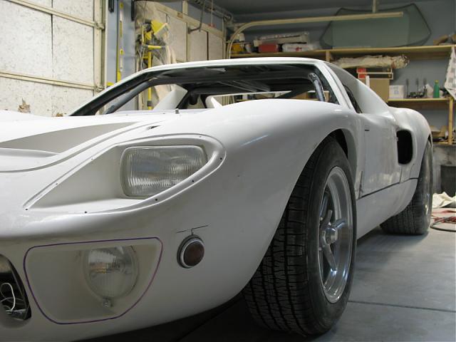

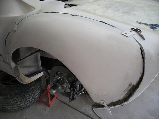

The other project stemmed from my work on the rear flares. Now that I had the rear fenderwells nice and tightly trimmed to the tires, it made me focus on the fronts. Everyone knows that these cars have all lived "interesting" lives and they were made a long time ago. End result? The mother car's race history and repairs coupled with a generation of mould making and my mounting job gave me a car with the left front wheelwell being about 1.2" lower than the right.
After tackling the rear flares, realizing I screwed up and then doing the one over, I decided that since I had put THAT much effort into it I would make the front match as well.
So in another moment of "What am I thinking???" the sawsall came out and sliced through some VERY thoroughly thought out cut lines. In the end I only made one slice a little too wide and everything went pretty well. I had spent a bit of time in the garage lately just staring at the clip and thinking about how I was going to cut it. I was also thinking about why I wanted to cut into a perfectly good clip, but in the end I guess my obsessiveness won out. If you compare the first shot of the wheelwell with the last one, it's clear as to how drastic the change is. It's looking a LOT better!
So yep, I've been busy. I (obviously) still have a lot of work to do to get it back to where it was but I am very glad I took the time to do it. My goal is to be in paint by the end of the year. We'll see what happens...

:eek: ((YIKES))!!!! :eek:
You need to meet a fella that goes by the handle "HOOFA" on the ffcobra.com site!
I sure hope this turns out as well on the front as it did on the rear...
I've been measuring the body on mine for symmetry and have found it to be very close so far. Unless I'm measuring in the wrong spots.. As you pointed out - these bodies were from a mold/buck that was an original competition car.
-edit- BTW, nice job on the seat! There was a thread on one of the competition forums I've been on for a number of years now about this way of making a seat. One fellow got some pretty bad burns from the catalytic reaction being so intense that it actually started melting the bag in spots. Turned out he had used Home Insulating foam...
