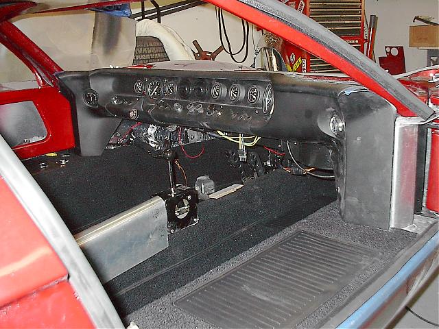

Time to post some updates. I got the carpets in a few weeks ago:
