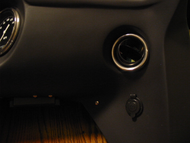

A little item that not much thought is given to, until you need it, is a power jack. Since most of our driving will be on the street, not the track, it seemed like a good idea. West Marine provides a nice water proof unit with a cover which blends in well. Marinco Model # 343576. We mounted it on the passenger side where anything plugged in would be out of the driver’s way, carefully centering it directly below the vent for aesthetic purposes. The radio “switched” power source and a separate ground were connected.
