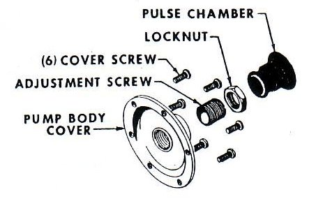

Not sure about a source for new ones (I could do with 2 myself!!) but I do have the original service manual for the pumps.
The manual states that the assembly at the top is part of the pressure regulator. It also states that the rubber end piece is a 'pulse chamber' although I cannot see any reference to it in the manuals.
Hope this in some way helps
Andy
