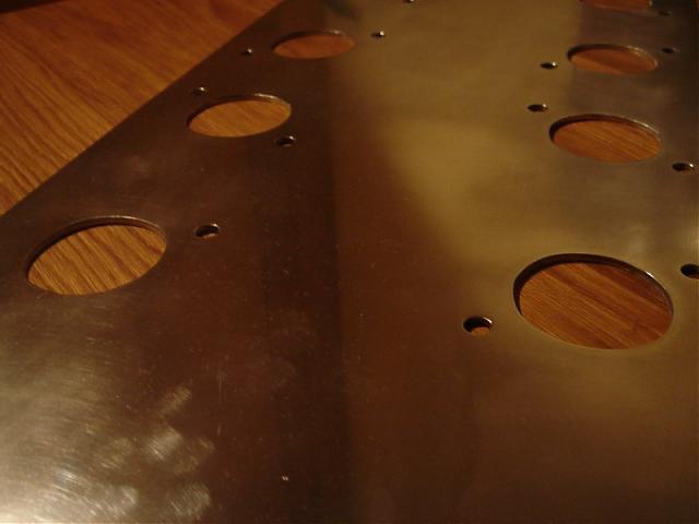

Does anyone have any ideas for sort of renewing aluminium that has surface scratching?
Car was someone else's project and has been scratched a fair bit during development.

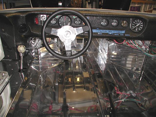

Troy, having messed with this a bit, I'd advise one of two things. Either scotchbright in one direction, finished with the WD-40 buff, or for a little more gloss (if that's what you may be interested in) Nuvite polish. This is mill finished and scratched up aluminum that looked comparable to your pic after having a go with Nuvite. This car will have no carpets, and as always, experiment first to test for suitability.

Holy smokes Brian - That's beautiful!!! I'd like to do that with my entire chassis!

Brian, that looks just brilliant ! I envy you in being able to contort yourself enough to get into all those nasty places down the footwells !

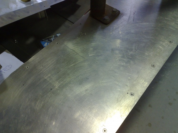

I'm in the process of polishing my turkey pan base after jigsaws and files scratched the surface. Started with 400 grit paper, then 800 finished with 1200 and am now finishing it with 'Brasso' a metal polish cream. Hard work but its got all the scratches out and is comming up mirror finish. Also use a buffing wheel, as even doing this small piece by hand has been a labour of love.....
Aluminium will oxidise with the air quickly so to maintain the finish you can paint the metal as posted earlier. I'm going to let mine oxidise slowly as the aluminium oxide acts as a barrier to prevent any further oxidation.
