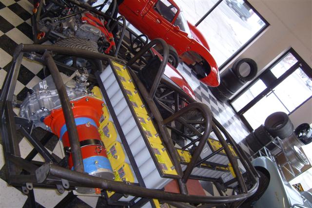

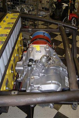

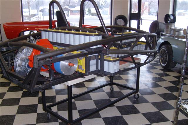

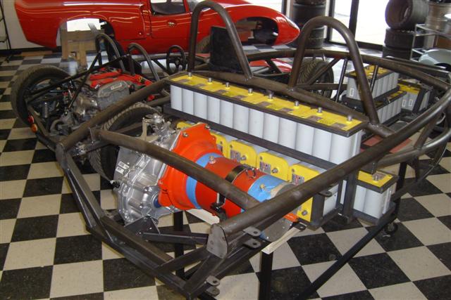

Here are a couple of pics of the Electrolite with drivetrain.....
Roadster Specs.
Weight < 2,000 lbs
0-60 < 4 sec.
Top speed 90 mph
Range 55 miles
Motor WarP 9"
Motor Torque 350 ft/lb @ 100rpm
Battery - Customer determined, packaging for 24 Group 27 batteries.
Controller Zilla 1000 Amp
Charger PFC30
Custom wiring included
Home based type charging ....no special charging post required.
The longterm plan will be to offer more advanced power source once they become more affordable and readily available..using lead acid allows the DIY access to easy resources and affordable replacement.
Full up price ...minus batteries is $34,995....
