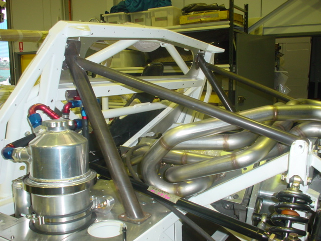

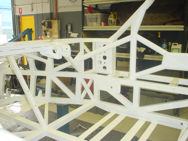

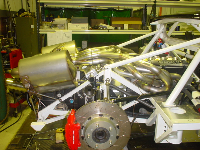

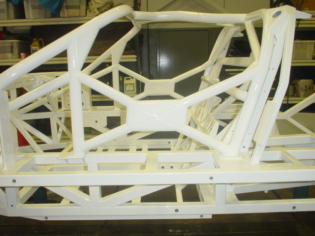

A couple of pictures as requested, I have found that the intrusion bars do not really pose a problem for getting in and out of the car. I would love to hear from Russ on how easy it is to get in / out with the top bars in place. I would definatley add them if it is still possible to make a "timeley" exit if circumstances require ! It is obviously a real weak point in our cars but I guess thats the risk we all take

thanks for all the great input guys!!
Iain, that is a cage!!! Nice work!
