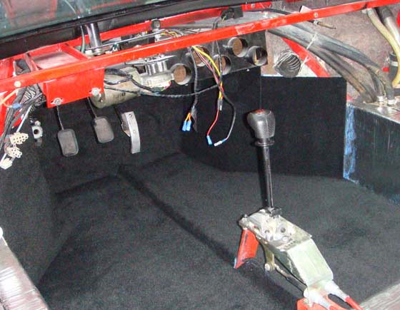

Brian, as usual, I do the installation different to the standard GTD fitment by turning the heater unit through 90 degrees, thus making the unit less wide and giving more room for the pedals/feet etc. I suppose you are building LHD, so that may cause a slight rethink on my method, but dont just jump in to what is "standard" as there is probably a better way, Frank ( how you getting on with suspension set up? ready for next instalment yet ? )

Brian, sorry I didn't see this sooner. Not sure if this will help much, but let me know. I haven't fixed the dash in again yet and may be able to shoot different angles later if you need.
Cheers,
Mark
