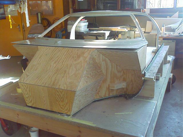

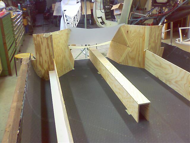

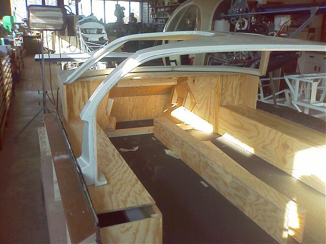

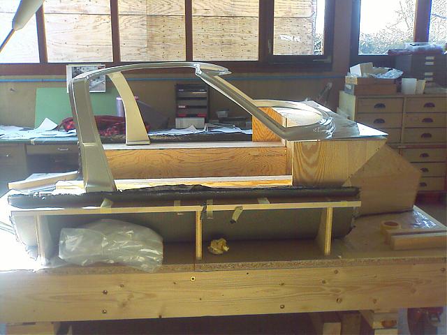

Now i turned the bottom.
We have until now on the under side from sandvich away 4 diagonal uni layers 2 uni on length and two uni from site to side,one Kevlar layer and only on the tanks carbon kevlar with possibility to let it be visible.
on the inner side of the sandvich we have only 2 layers now.
now i build up with plywood.
