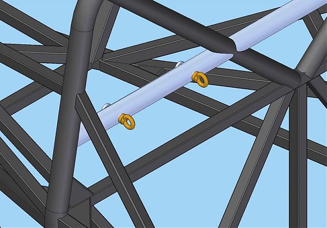

I'm thinking about how to mount the top harness eye-bolts. In common with GT40's I've got an engine immediately behind the roll bar and don't want straps going into the engine area as that seems a recipe for disaster.
I'm also trying to achieve a flat face at the back of the roll frame to make it easier to mount the fire wall.
What you can see in the picture is the 44.5mm x 2.5mm DOM main loop and all the other tubes are 38mm x 2.5 DOM.
The intention is to put top-hat bosses into the horizontal tube and bolt up the eye bolt through that.
On the downside this leaves the threads taking all the applied load in a prang, which I'm not sure is a good idea?
Does anyone have any experience of doing something similar or other recommendations instead? Would this sort of arrangement be FIA sanctioned (I ask that as they seem to have the highest standards)?
