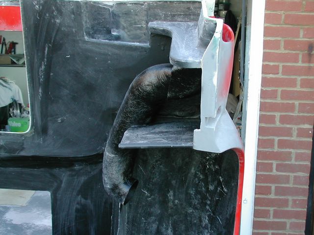

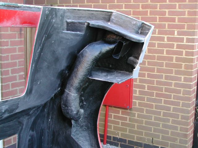

Thanks peter,
I'd never seen those front extensions before. I feel more comfortable now the gaps are closed.
Here are two photos of the original rear ducting I've also installed. I've extended the inner arch and added a weather strip. This closes down on the sill extensions I made earlier and forms a good seal so no dirt and muck can get onto the fuel pumps etc.
