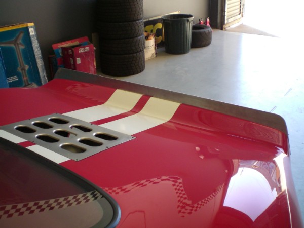

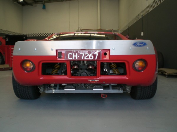

As I have previously mentioned upgrades will continue on my car.Here is the latest. An alloy rear wing fitted as per GT40 race cars except I couldn't be bothered slotting the bolt holes to make it adjustable. Looks good let's hope my downforce improves to match. I made it out of 3mm aluminium (that's the correct spelling isn't it Russ?) We will test it at the upcoming State Race Meeting at Sandown this weekend.
Ross
Ross Nicol
put the photos up Ross

Hi Ross,
I've just fabricated one for mine. Will be finished this week (Vent holes and slots included) He He..
My GT40 is a long way from being finished but I'm really interested to see the performance results you get from having it on your car.
Always enjoy your posts,
Cheers,
Martin

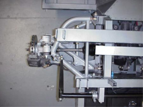

Finally got around to installing the rear anti roll bar. I will be installing a cable through to the cabin for cockpit adjustment but will do that later. Testing will start this weekend as I'm racing at Winton.Be nice to at last be able to balance the handling.New front brake pads installed too so some bedding in required. I'll let you know how it goes in my post race report.
Ross

Nice job Ross.. I see that you have them set for full-on stiff right now.. Did you reduce the rear spring rate at all? She may be a tad loose this way so be on guard!
