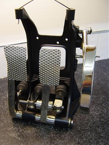

Russ,
This is the original configuration with threaded clevises but my lock nuts are missing in this shot.
I also machined the balance bar with opposite hand threads for quicker adjustment.
