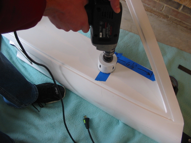

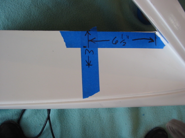

West Marine sells a cup holder insert, part # 395160 (black), $5.99 each, which is ideal for the GT. (www.WestMarine.com). It has a 3 ½” flange and a depth of 2 7/8”. Simply drill a hole on the door sill and drop it in. The hole should be slightly undersized to assure a tight fit in the event of a roll over. The inserts can be ordered in either black or white, so an appropriate color to coordinate with the cars décor should not be a problem.

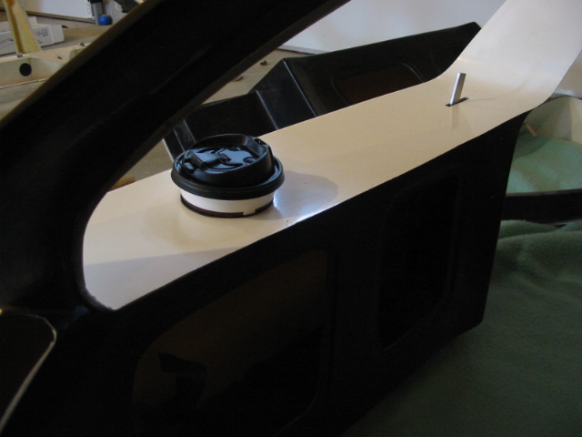

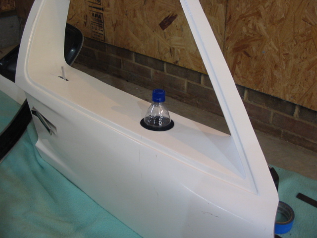

We found that a 12 ounce bottle of water fits well. A Burger King “Cup of Joe” is a tight fit (as you can see in the picture), but a Starbuck’s “Tall” is easily accommodated.
