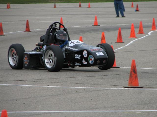

Our Formula SAE car last year had very little camber correction in the rear, and it was quite evident when standing behind the car as it powered out of a corner. in this picture, you can see the rear wheel going a little into positive camber and the tire really starting to be pulled under. I wish i had a better view of this, you don't see it too much from this shot. This year, more correction has been added to the design.
