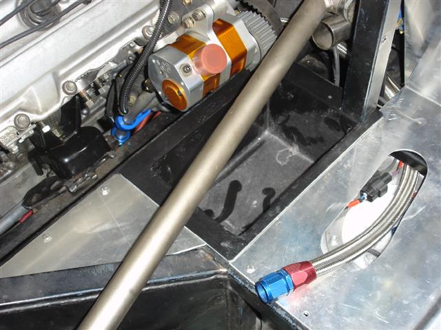

Oil System
The dry sump system uses the stock oil supply pump. The supply from the remote tank is through the sump pan so that, if the engine blows up, all the components can be swapped to a new block with no modifications required. Two pick-ups return the oil to the remote oil tank via the scavenge pump. A sump vacuum sensor will tell me if the scavenge pump stops drawing (say the drive belt breaks). The stock pressure sensor is used to confirm supply to the engine. A drain hose runs from the tank underside down to a screw cap mounted on the lower chassis.
An oilstat controls the flow through the oil cooler and gives the oil a chance to warm up on cold days. The oil cooler is mounted in a shroud and sealed against the clip so that all the air coming through the vent will go through the cooler. It’s set back so that any stones will hit the back panel and not the cooler. We couldn’t quite fold the shroud out of one piece, but it will look good when welded. The oil cooler shroud will look the same from both sides.
We were having trouble running the oil lines and fitting all the kit up against the bulkhead. The solution was to mount the filter back on the gearbox. This freed things up and makes it easier to drain / remove. The idea came from a forum member’s car. I don’t have his name, but thank you, sir.

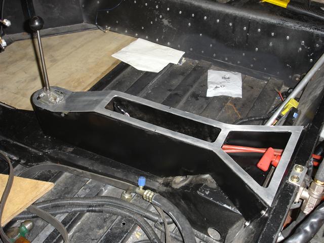

Console
The alloy trim to the console has been made. The alloy gearshift surround and gate is being machined now. The gearshift cables will be covered by the floor of the rear compartment. Kill switch hidden in there along with the control for the heater, which can be seen behind the bulkhead. An extension handle to control this is being made up now. Switches for doors and mirrors are being mounted on the sloping section now.
The bulkhead panel is being made up now. I’m going to try a clear perspex bubble to cover the blower drive pulley (noise permitting). It will let you see the engine spin up by your shoulder and should scare a few passengers.
