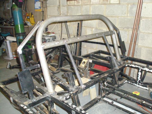

Hi Roger
If you're going for a full roll cage, why not get a horizontal bar added to the main rear hoop to take the fixingss. The attached is what I've done on my Tornado chassis
Regards
Andy
