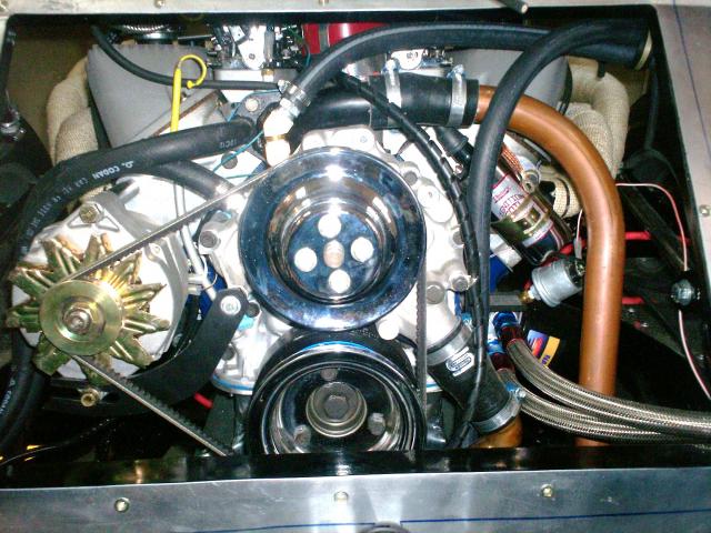

Todays activities;
Started ignition wire routing setup so I can cut the wires to length and crimp the ends then put the boots on.
Layed out the rivet pattern for the left cockpit closure panel and fit the oil cooler then fabbed the hoses.
Fit the coolant purge tank and hose setup.
Body and paint soon :stunned:

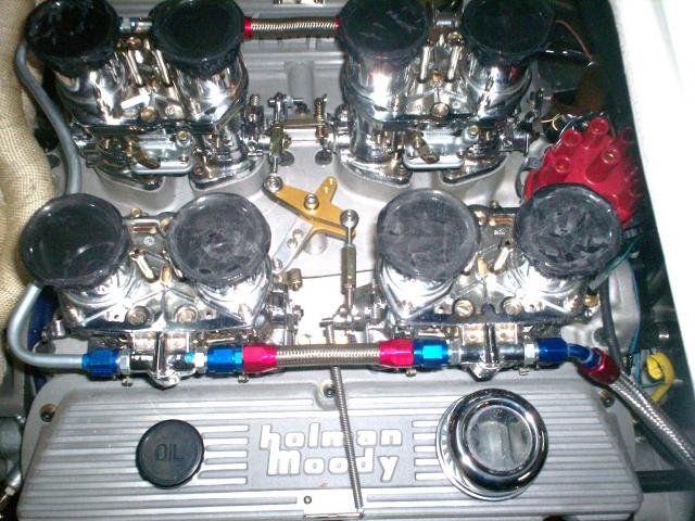

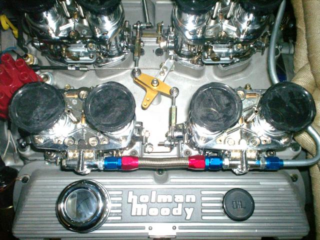

Just a quick update today.
Rigged the throttle cable for the Webers.
It is visible on the front of the engine with the spiral anti - chafe wrap on it.
S

Scott,
If only my progress could be so brisk and still so proffesional. Nice job indeed. Do you have any concerns regarding using copper cooling pipes with aluminium rad ? I'm no expert but just maybe worth a mention.
Best regards and in admiration,
Martin
