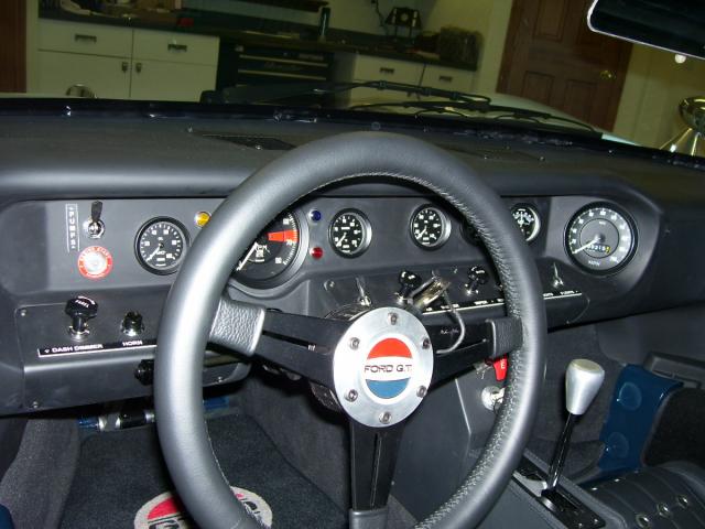

CAV ammeter by Steve (NOS stock purchase from EBAY UK seller...much better than SPF stock meter as it is industrial grade meter rated for 60A and has nutted studs for wiring tie in vs the factory 50A gauge quick connect blades...no illumination so I drilled a hole in top of gauge housing, installed proper size rubber grommet and used SPF supplied plastic socket with a red bulb condom over the clear bulb).....Switch legend plates by Lynn Miner

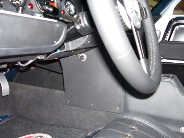

Door handle (strap) idea Lynn Miner..Steve install

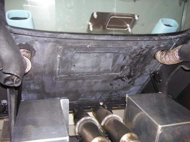

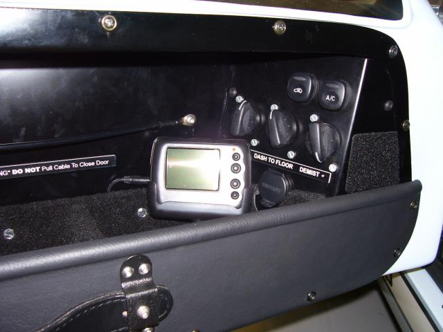

Rear view camera (it workks!) and black power plug covers (from Toyota parts to replace SPF red covers by Steve

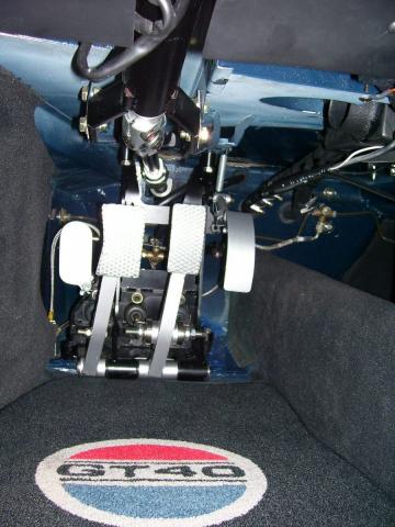

Dead pedal by Olthoff (custom not factory that is too high and interfers with clutch op)
Accusump control switch by Steve
Center steering wheel boss and badge...Boss by Frank Catt, badge from Fran Kress
Rear clamshell thermal spray by Olthoff (used to insulate truck engine covers...spray on not adhesive backed sheeting that can come loose)
